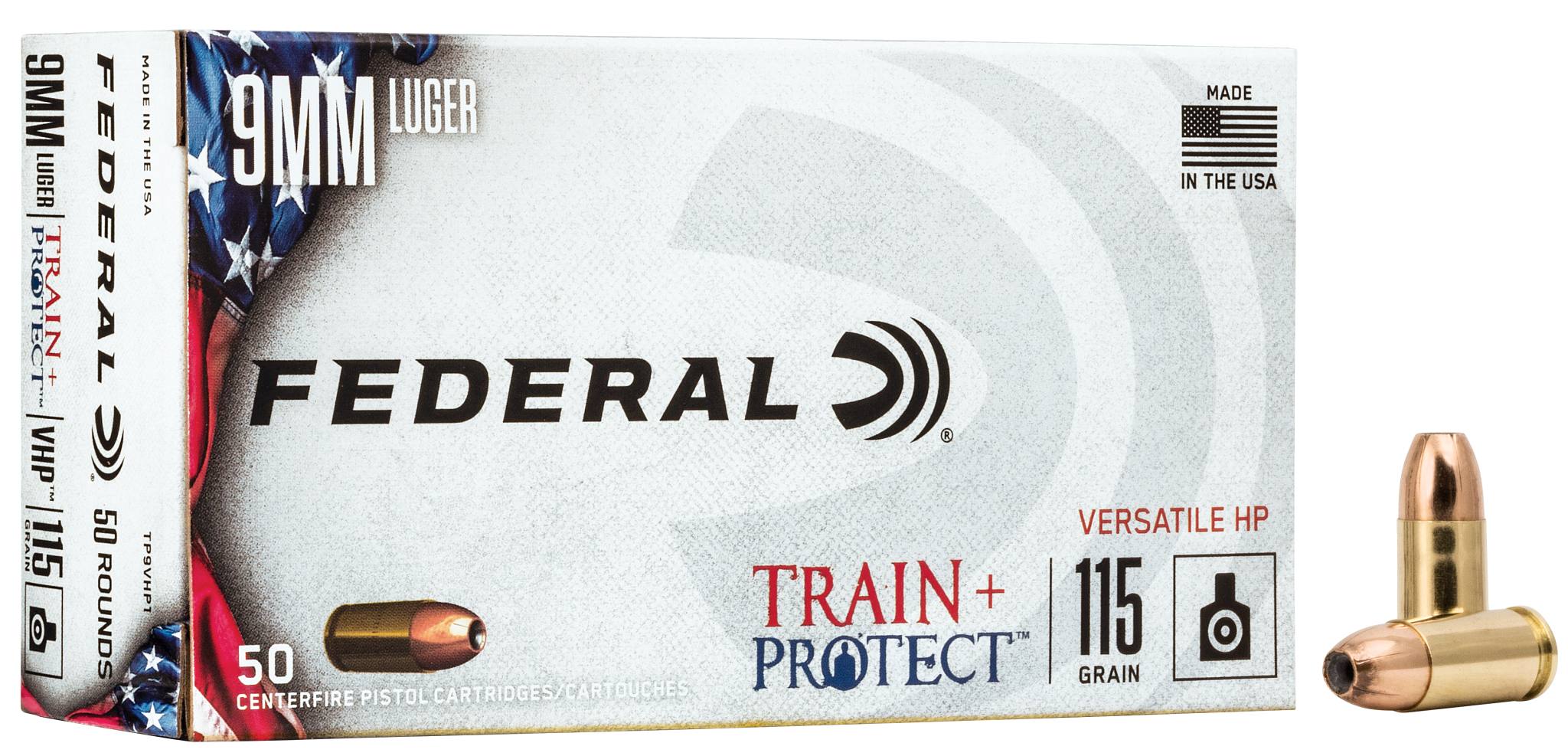

Federal sells boxes of train and protect ammo.
For other, just compare their ballistics from published data.
